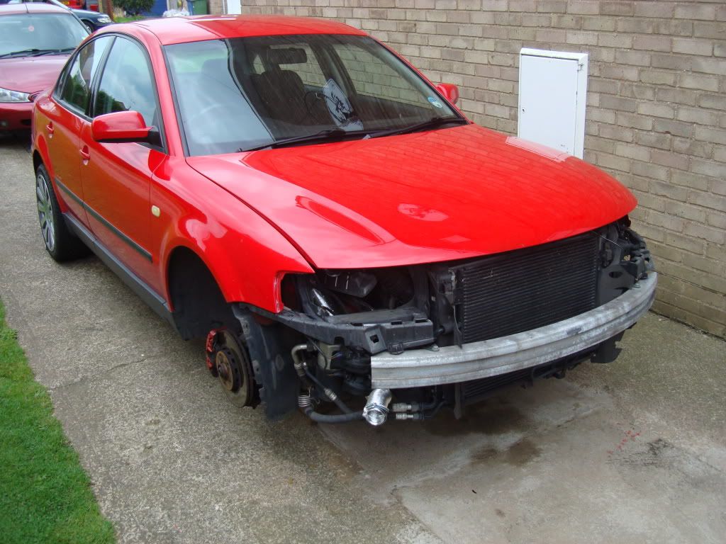

    I agree with norman the first thing I did was remove the negative battery connection to make sure I couldnt damage it more. We are slowly getting there with it but because we both work all day its a slow process! The timig belt looks new so the tensioner is suspect at the moment but will find out soon enough. I am going to change the cambelt / water pump / tensioner / coolant / oil etc anyway now but will see what happens. Looks a bit horrific at the moment!

    By the way that is a very nice looking car you have there.

    Thanks norman its nice to have the support of people. Its not easy seeing my pride and joy stripped down at the bottom of the drive will update when its fixed!
