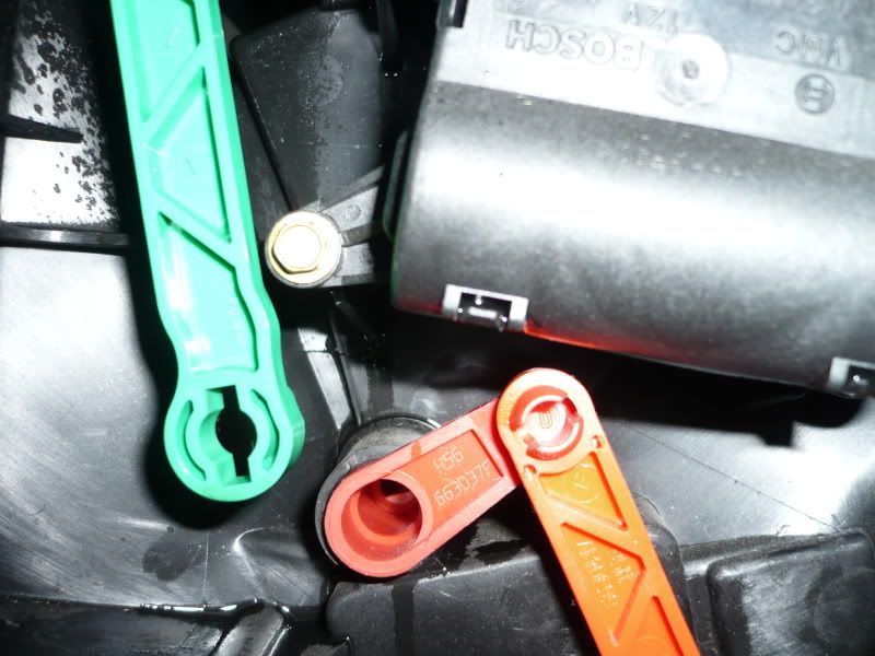

    I take it you've got climate control??, then take out the glove box and check the small motors which operate the system could be sticking.disconnect the motor from the lever and operate by hand.PS are the pipes to the heater matrix getting hot?
