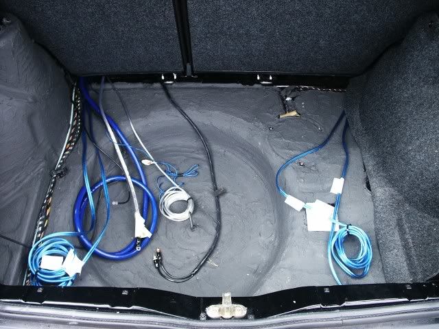

    Here's a pic of my boot from when I was soundproofing it for my ICE install. The saucer disk you describe will be that thing that I have painted five coats of sound deadening over, which you can just make out the three screws on then. Time for me to get the stanley knife out
    I'll have a play at the weekend.

    Youre on the spot,just dont cut the cable's top centre of the cover.To test the sender unit in the tank(not smoking or playing with any source of ignition)just remove the connector socket,then the 2 fuel lines(fuel&return line)very gently with by using a plier(widemouth)to press the clamp squareish(the origional is crimped)and this loosens it up a little. next a left right turn using a decent plier without the strenght of a madman to slowly wiggle the pipes off and there will be a few drops of fuel so be carefull or youll have a very hot day to remember.next is just to tap the black collar off anticlockwise till loose(use a blunt wide chisel or other flat steel object and knock gently without destroying anything.once off the top of the pump is 2 tubes on a round disc that can be shifted out of the way(only a few cm so you get your hand in the tank)looking in youll see the float(orangy colour ball)on the right,connect the fuel hoses(just to stop fuel spillage)and the connector and have someone turn the ignition on but do not start the car!!!!!!!.let them tell you what the needle does then lift the float gently higher and if the needle doesent respond accordingly or creeps then thats the fault and you only need source a new sender but they are avaidable.keep the tank clean dont let dirt get inside.good luck.
