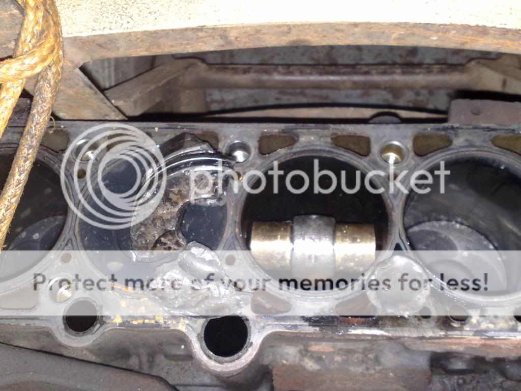

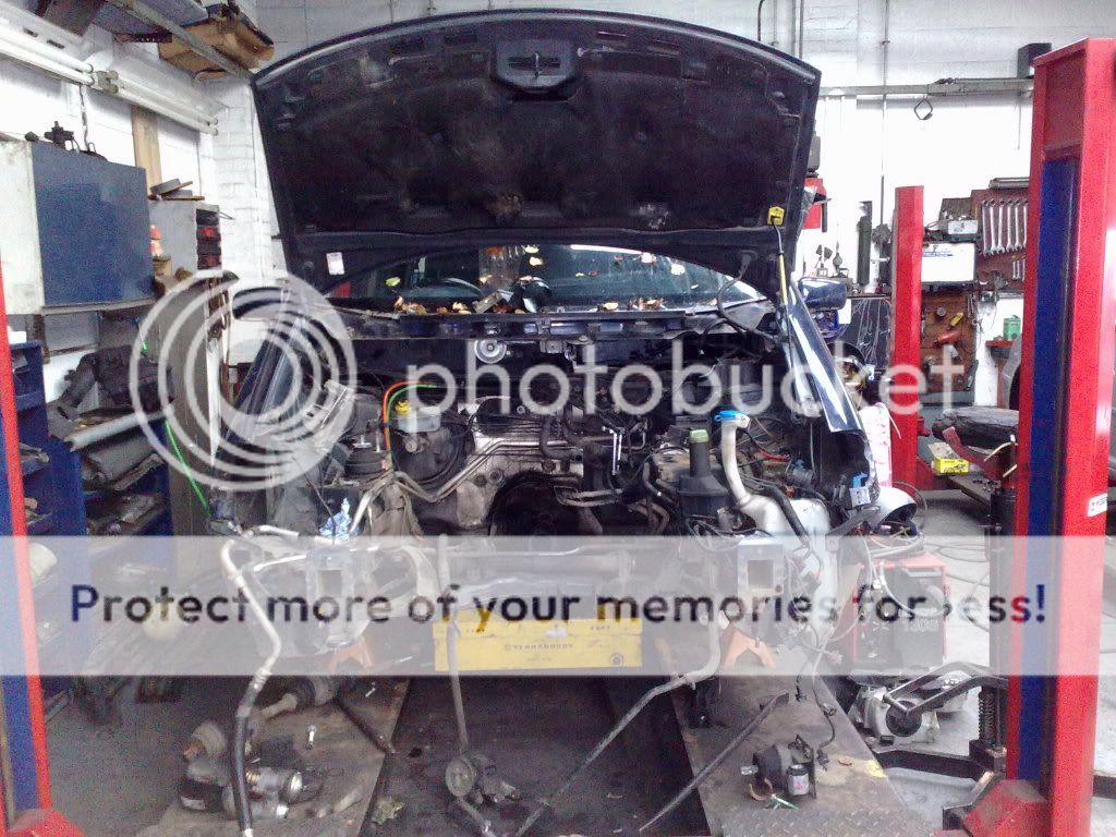

    Look what they done to my Shaza!

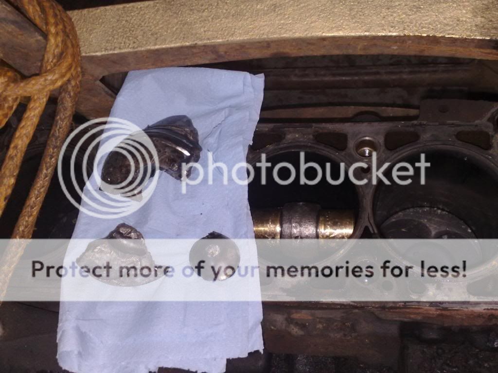

    And look at what they found. Ouch!
    She is all better now though. £1200.00 later and running as sweet as a nut! And so quiet too.
    Big thankyou too VW2000 in Peakirk, Peterborough. Jim and Kev are the Dogs !
