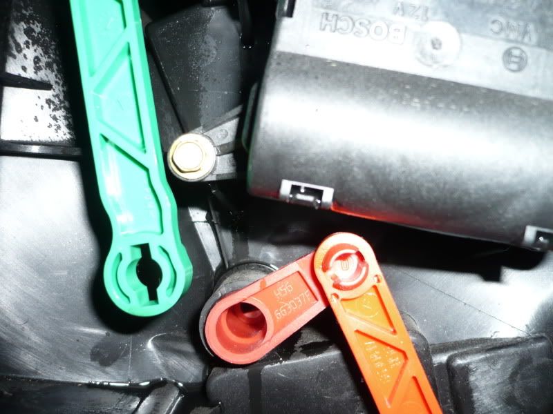

    When you say the righthand side do you mean drivers side?what was the servo number,should be like e.g v158 or v159,anyway I'll post you a pic of the passenger side one's, if its the other side, they are awkward to get at because of the pedals.

    Quote Originally Posted by nevo View Post
    Thank you yes it is the drivers side and itis yellow does the yellow one open the drivers side flap of the a/c for the temp thank you for your assistance

    Try the yellow one,unbolt the servo and turn it 90 degrees and remove it then operate the lever by hand,see if you get any heat out.

    Nevo yes mate I fixed it today there was a loose wire thank you for your help
