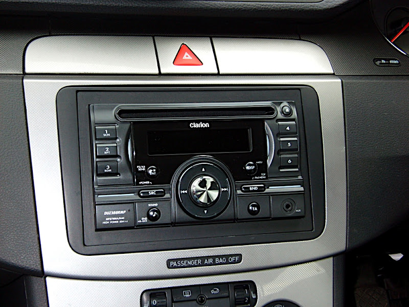

    To give you an idea, this is what I did:
    Passat before:
    Passat after:
    Golf before:
    Golf after:
    As you can see, I'm not lightshow fan - the Radio 2 shot there is genuine - I have, now, actually more switched to Radio 4. How old and boring does that sound?!?!

    This should cover your questions - it's a thread that covers what I bought to fit the stereo and how I did it:
    https://www.vwaudiforum.co.uk/forum/s...ad.php?t=38059
    It is, by the way, a Clarion - model DUZ388RMP - I'm not sure if Clarion do it any more either, but you can get it here - http://www.caraudiodirect.co.uk/clarion-duz388rmp.html
    ETA - I don't think it does cover what you need... You'll need - a FAKRA (ariel) adapter, a CAN BUS adapter (don't get the cheaper convertor) and the fascia kit.
    Another link that may help: https://www.vwaudiforum.co.uk/forum/s...ad.php?t=70838

    The nice thing with the Clarion is that it's got "256" colour options which means I can blend it in with the Passat or the Golf's interior:
    Or white (as you can see above) - Or green, pink, etc....
