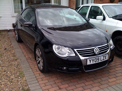

    In the meantime I've got an '09 Eos convertible which looks slightly ghey but is lovely to drive (and I'm quite sure its got the same engine as my audi)...

    The lovely to drive but incredibly ghey eos...
