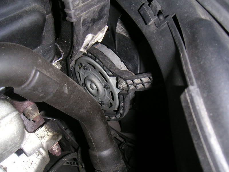

    You're on the right lines, but the bigger fan, numbered 06, 07 & 08 in your schematic can be seen on the right in this pic:

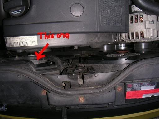

    But it's the other, smaller fan that's being noisy. Looks like it's held in the housing by three nuts and bolts:
    But I doubt there's the room to get it out without much more dismantling
    Gaz
  5. #5
    Oct 2005
    Lutterworth
    683
    Quote Originally Posted by GTW View Post
    You actually get the whole assembly that is held in with one screw !
    Release the cable that runs to the connector beside the PS reservoir, you will have to drop the undertray and grovel underneath; then undo the single screw and rotate the whole assy a few degrees and off it comes.
    There was enough room to do this on my 1.8 petrol and from your photo there looks like the same amount of room on yours.
