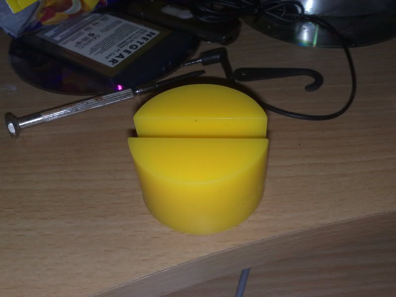

    or get one of these

    or get one of these
    Where from ?

    Thanks for the replies I used the jacking point and bits of wood method and all went well. I too like the look of the yellow plastic gadget, is it specially made for the job?
