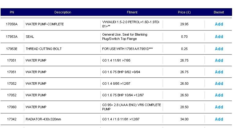

    GSF list the pumps below. Is it the top item, 17058A?

    i think thats right, and comes complete with the housing.

    The pump was the top one from the list above. It comes with the water pump housing. I would recommend also ordering the plastic elbow and outlet while you are down there. Method was to remove the alternator and the alternator bracket. The pump then comes off easily.
