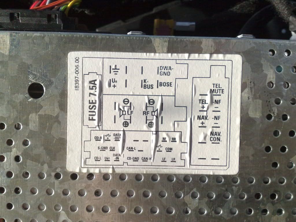

    2. There's no audio from the rear speakers, but the front ones are fine. Looking at the connection diagram on the top of the Concert unit, this would seem to be explained by LF & RF being the only connections that have been made via the harness adapter.

    some photos of the existing unit...now back in the car.

    Your car has no Ignition feed in the factory loom as the original unit switches on/off using the CAN data bus.
    You have the basic non-Bose audio looking at your connections so I think any of the leads you have suggested will do, but you will still need to hard wire an Ignition feed from the fuse box or possibly the cigarette lighter to get that side of things working correctly.
