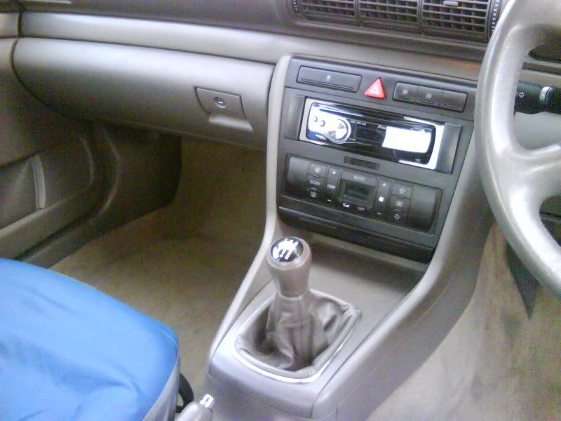

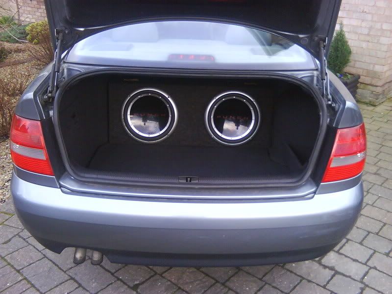

    Just put these 2 rockford fosgate 400W each i think in with the box for £95 !!
    i also got given an amp which is mutant but screwed to the back of the box!!
    so i thought id get a new headunit which is pioneer it cost £80 on sale from 140 !!
    hope you like the pics.....
