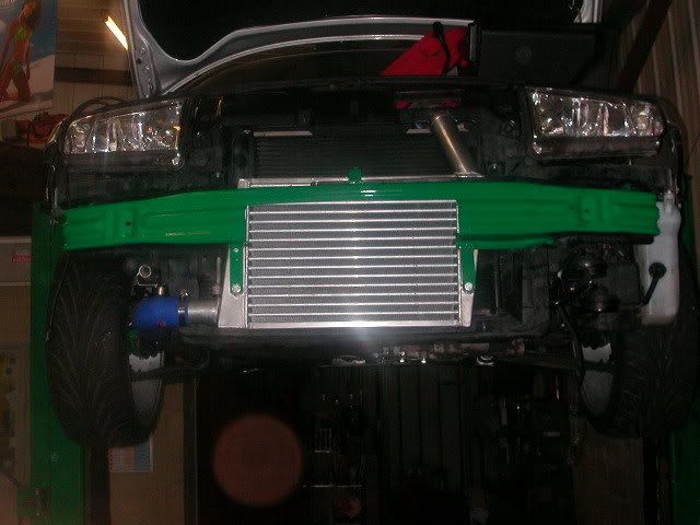

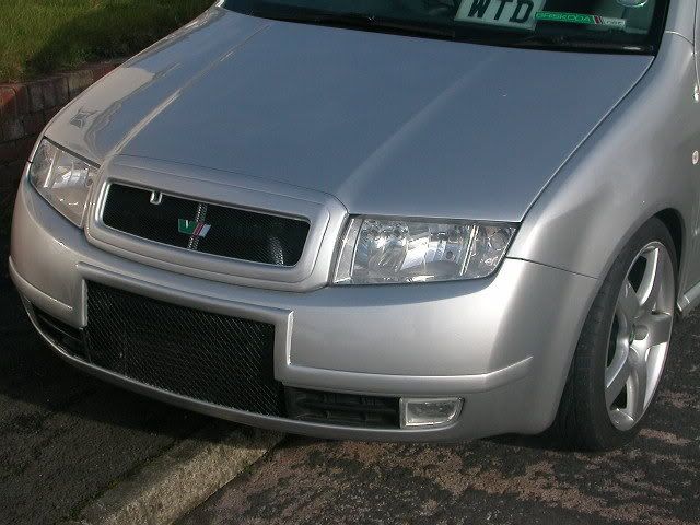

    Well, I would say biggest bang for buck is hybrid turbo and just go easy on the remap. You only need to compare the side mounted IC to a front mounted one to tell the difference. Also note the side mounted IC is hidden behind the bumper so does not get direct airflow - my front mounted one is exposed 95% to oncoming air.
    Side mounted down there in bottom right side of car (note this is not my car now but one I crashed and broke for spares 3 years ago)
    And my current front mounted IC
