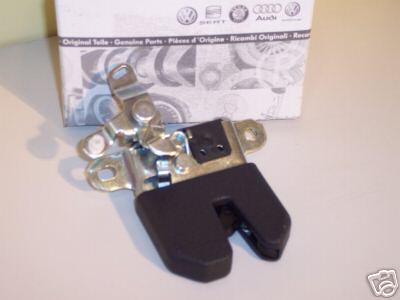

    Hello today so I pulled out of ********* got down the root and my car informs me that the boot is open, so I pulled out and yup, it's ******!
    what the problem is, is the lock mechanism doesn't lock, i close down the boot but its not locking, and on the mechanism there's like a tiny latch which should lock in place, however its really loose so i'm guessing a spring has broken.
    But my man question is, to replace the lock mechanism is it just disconnecting the wiring for central locking, take the cable out for th lock and undo the 2 bolts that hold it in.
    Fit with new part and reverse the process?
    This is the part, is the module for the electrics included in this or do I have to take it off the old one and put it in the new one?
    all my electrics work as I see it working, just the lil latch isn't locking
  2. Re: Boot Lock!!
    Oct 2007
    6,322
    Hi It is as you thought,the only thing is,iam not too sure if the micro switch,comes with the new lock,and if it doesnt,then you will have to transfer it from the old lock

    Hey up, managed to leave work and got it all fixed before darkness. I got confused with the little white electric bit at first, but seemed a breeze.
    Once it was all connected up and screwed in, the electric boot release on the boot didn't want to work, opening boot via remote, lock barrel and inside worked, just not on the boot.
    I got ****** off with it and just thought I got other ways of opening it, put the fabric carper padding back on, closed it, locked car, opened it again then the boot button worked, so win win!
    Part only cost me £16.34 something from VW in Hedge End, Southampton.
    Very pleased, thanks for all your help people
