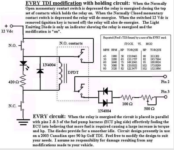

    Has any one ever tried this
    http://forums.tdiclub.com/showthread.php?t=12165
    Any opinions or experiences?

    Ive just done this with a 1k pot and set it to around 700 ohms.
    WHAT A DIFFERENCE!!!
    Car goes so well and there is no smoke or dodgy idle. Highly reccommended!!
    And these TDi engines run with an excess of air - so adding extra fuel increases the output of the engine. If there is no smoke this would suggest the fuel to air ratio is not too bad

    This mod tricks the fuel temp sensor into believing the fuel is warmer (less dense) and therefore injects more diesel to compensate. This is essentially the method all tuning boxes operate on albeit some are a little more complicated with funky waveform control signals etc.
    There are several tributes on the above site that have been running this mod for many miles with no adverse effect.
    Personally I think this is a worthwhile cheap performance mod, well worth the £4 i spent on it!!!

    If the engine is running lean at full throttle, such a modification WILL give a power increase (at full throttle)
    What would be really interesting would be to get it on a rolling road with a gas analyser and see the numbers.

    so the ECU is not responsible for regulating the quantities of fuel injected? Sorry, my bad, after spending many hours watching remappers at work, that's what I had learnt, perhaps you could explain how you've come to a conclusion to the contrary?
    Quote Originally Posted by thefoolmccool View Post
    Where does the extra power come from then???
    indeed, where 'is' the extra power you're so proudly proclaiming to now have? I presume you've had the car dyno'd to verify this astounding fact.
    Truth be told, if what you say is true, then why would we all bother to have remaps, when we can just trick the ECU into thinking the engine is cold all the time?
    And since there is no big puffs of black smoke the engine isn't overfuelling too bad.
    granted, however, this does not mean the engine is not being overfuelled full stop, does it?
    with all due respect, you're teaching grandma to suck eggs, I know exactly what this modification does, I've seen it discussed far and wide for a long time and the general consensus remains the same....
    Ahha.... but the same justification is applied to terrorism by terrorists, does that make it right? .....
    As said, I care for my diesel engine, fooling the ECU into thinking the engine is colder than it actually is, is not, IMHO, a good thing.

    Fair enough. I reckon I will run it for a while and see if there are any adverse effects. The only potential problems I forsee are increased carbon build up - but I am going to keep an eye on MPG figures as a crude indication of this. The other problem miht be high EGT - I don't know how to keep an eye on this without expensive instrumentation.
    Anyway , as I said, this car is only a runabout and I'm not too worried about it.
