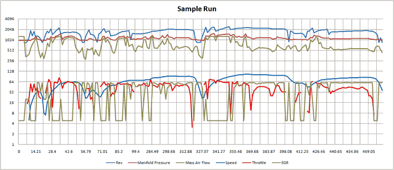

    I decided to then log some data during a short run in the car and I notice a few strange trends, including the EGR valve. Please see the graph below.
    I am not too sure where to start and would appreciate any advice on how to proceed with identifying the root cause of my problems.

    Take a look at this thread. It is for 2.5TDI, but the principles are the same. I don't know if the 96 B5 engine had the variable vane VNT turbo, but if it does, just follow the links in the thread. https://www.vwaudiforum.co.uk/forum/s...ghlight=teflon. There are some links to diagnostic info at TDIclub.com, including a very detailed description of how to interpret the diagnostic graphs you have. Look also at the TDIClub.com turbo101 forum for lots of info - it takes a bit of rooting about to find useful stuff though!

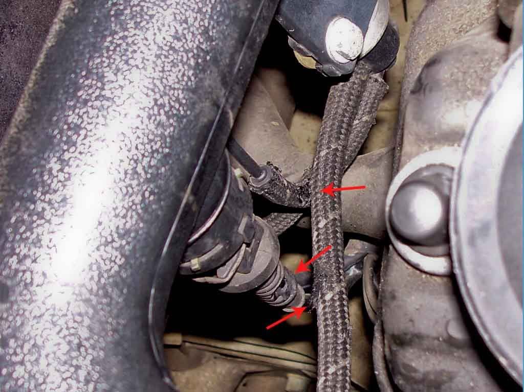

    Second is a photo of a small split in the hose connected to the EGR valve - I am not sure if it is just the braiding but this will need replaced for sure as running along the same pipe and I spotted the damage as shown in the third photo.

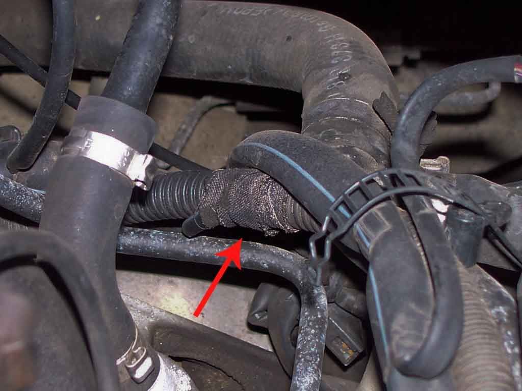

    On the other side of the engine I noticed a bit of (un)handy work by someone that looks out of place. I am not sure what this tubing is for but I am guessing it is most likely electrical cables?? However I am sure it should be protected by something more than a rag, lol.
    I hope to get a really good look around the rest of the car during the weekend. In the mean time I will try some of your suggestions guys such as trying to force the problem and I still have to log another run in the car.
