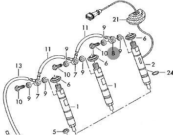

It's very odd since it appears to be coming from the banjo fitting where the return line comes off. Here's the setup...
I took it all apart and it appears that the sealing surface under the copper washer on the injector side is irregular.
There seems to be a slight "step" in the injector body and the washer can't seal 100%. Don't think the injector body is cracked...that'd be a bigger prob. Tried replacing the washers, no dice...
