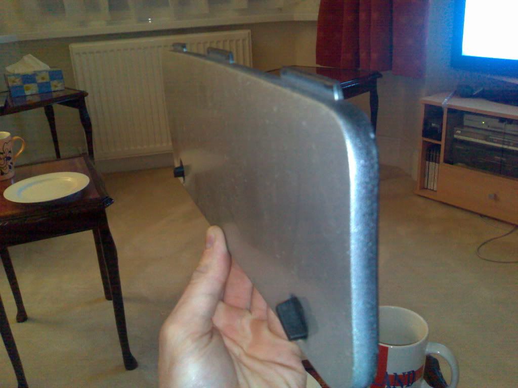

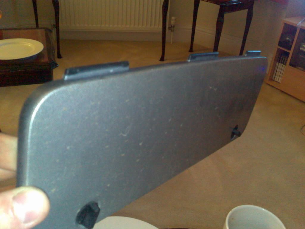

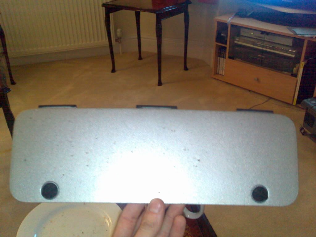

    hello,
    I have one on these removeable covers on my golf mk5.
    mine measures approx 13" x 4" but i would assume that the way thay clip in would be the same.
    I bought my own lower skirt from vw all in £49.91.

    Sounds like the cover is 1/2 inch all round too small for my bumper hole and is designed to fit into a rebate as you describe. Presume its similar to the pic from GOLFMK5GTTDI with thumb wheels to lock it in.
    I'm up near Liverpool so too far away but thanks for the offer. My dealer said he had ordered a tow bar bumper so will see if that is in yet and I can try the cover.

    Thanks for the great pics GOLFMK5GTTDI thats most helpful
    cheers, David

    Hi David,
    my cover is very similar to Golfmk5gttdi, only a slightly different size.
    Good luck, cheers Steve.
