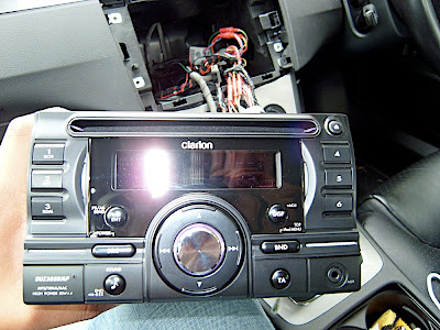

    Well, I've taken the plunge and bought me a new stereo:
    I just need to fit it now with all this lot.....
    And more
    Here's hoping the Clarion Can-Bus adapter works....

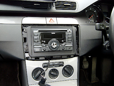

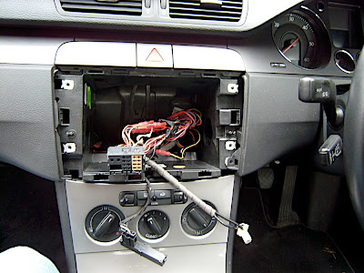

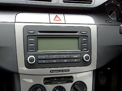

    All fitted:
    Before:
    Hmm, I've got to fit all this lot...
    What a mess.....
    It Works!!
    And it fits... I didn't use/need the cage - not sure how I would have fit it anyway
    The end result
    It plays and controls my ipod brilliantly, it'll scroll through and pick through the menu and actually show text properly - far better than an OEM one ever could. It took me about an hour an a half to fit, but only because of the fact that I read the instructions and because of the bloody mess the ICE people made when they fitted my Parrot kit.
    Note that where it says "If you have a VW, change this fuse"... Don't - it won't work if you do.
