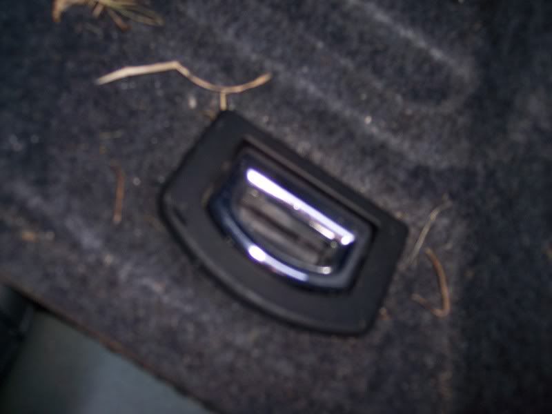

    Here goes:
    Open boot and remove spare wheel.
    There should be plastic trim just above the reg plate that the bootlid falls down onto. This is removed by unscrewing two screws internally either side of the reg plate width.
    Remove this plastic trim. It should have the boot light buld built into it and you have to remove the connector to fully remove the trim.
    The carpet trim that covers the inside of the right hand rear wing should be removed by unscrewing any securing screws - these should be visible, they should be the buckles that are used for tying any loads in the boot.
    Gently prise sections of the carpet trim away from the right hand part of the bootwell - have a flat-head screwdriver at hand to help. There should be metal clips that you need to prise off here.
    The alarm and battery unit should then be visible down beneath the rear right hand light cluster and is secure to the body by means of a metal bracket. I think I remember that you need poss an 8mm hex socket to remove the alarm.
    Hope this helps.
