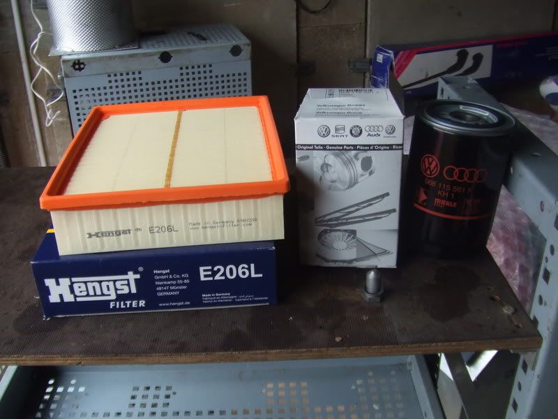

    Here is how I did a lubrication service on my Passat:
    It’s a 1999 1.8 turbo petrol engine, engine code APU.
    It has done 118466 miles.
    Items needed for this service:
    VAG oil filter(larger size) part number V068 115 561 F
    VAG sump screw part number 908 132 02
    Hengst air filter
    5w40 Fully Synthetic oil to 502 spec.. 4litres

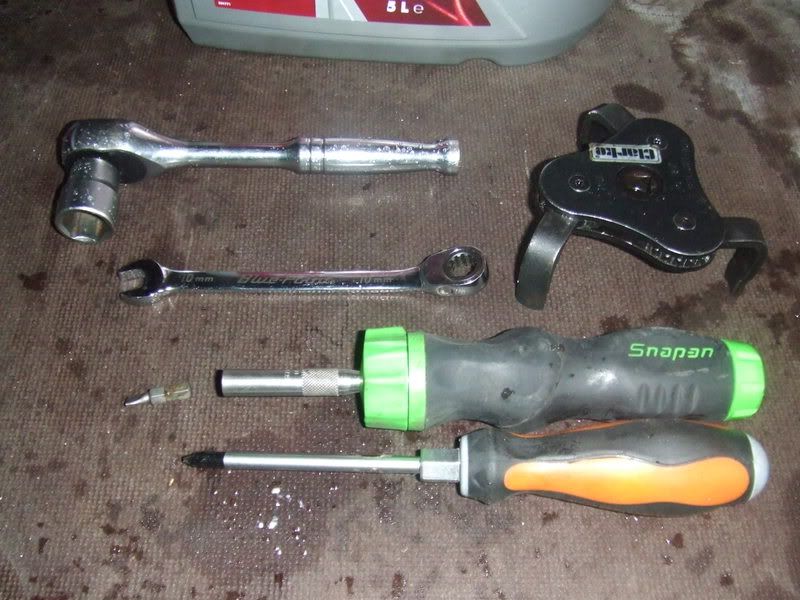

    Tools to carry out the service:
    10mm Spanner
    19mm socket and ratchet driver
    Oil filter removal tool
    Large slot screwdriver
    Philips No2 crosshead screwdriver
    Funnel
    Oil drain pan
    Disposable gloves
    Clean rags
