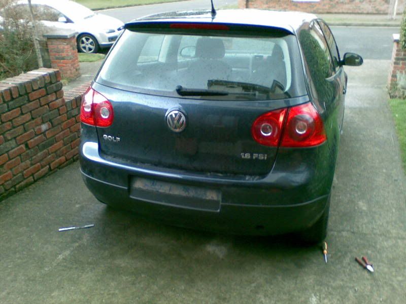

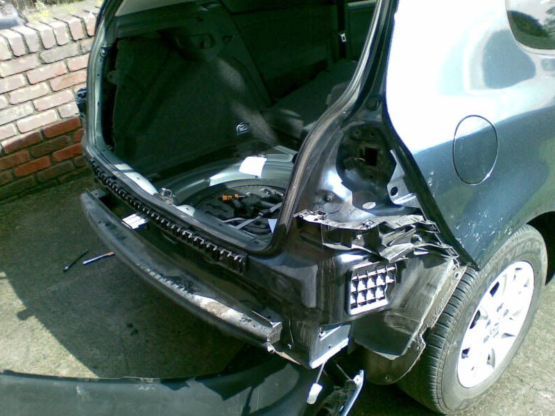

    Just finished fitting it there,
    I think your estimation of the time was a bit off!!
    Ended up taking me 2 Hours, probably because ive never done something like this before.
    Problems i encountered were,
    Those Gromits are IMPOSSIGBLE to take off without breaking!
    When i had the bumper off i spent about 30 min trying to unclip the two bits from each other, wouldnt come away easy
    Then when i refitted the whole lot i realiswed i never put the clips back on the lower section i was replacing,the ones you screw into, so had to take that off and do that again.
    Also i put the wrong lights into the wrong sides above the number pplate and i ended up getting a bulb error light on the sdashboard.
    Anyway all is done,
    here are 2 pics of it if anyone is intrested
    i must say thank you golfmk5gttdi
    i owe you a pint!
    Thanks
