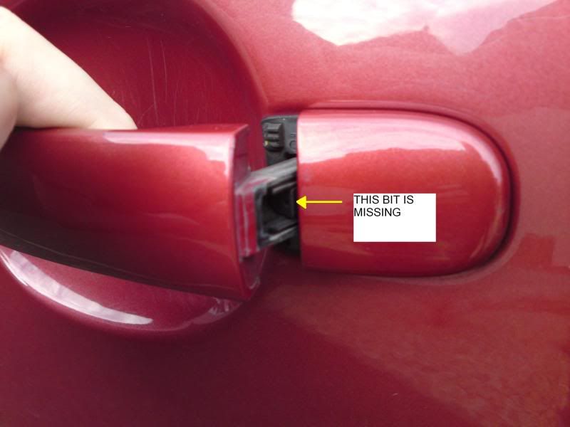

  6. Re: Rear Door problem
    Nov 2007
    122
    I realise that this is an old thread but did you have any luck fixing your problem?
    My dads rear driverside door has recently started giving him problems. It locks/unlocks fine but can only be opened from the INSIDE. When trying the handle from the outside it does nothing.
    Having compared it to my own Passat it appears that there's a small bit of plastic missing from the inside of the handle - see attached picture.
    Anyone know how hard it is to change the whole handle (or even just the pictured bit of plastic?)]
