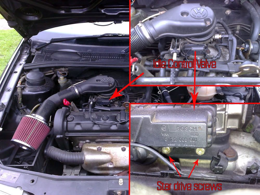

    Hi Cragus,
    Nicely done, can I ask you how you located and replaced the idle control valve please? I am having problems finding an answer to this and any help much appreciated!
    Regards,
    Bendeneo
  8. Re: Golf Mk3 Problems and answers...
    Feb 2008
    Rugeley- On - Sea
    12
    Hi! Yeah sure here is a diagram showing the Idle Control Valve. It is held by 2 star drive screws ( star drive screw-drivers can be found on e-bay reletiveley cheap )

    hi all
    sorry this is a bit off the subject, just wondering if the air filter and induction system photographed here is standard or is it a performance part, looks better than my big paper filter airbox?
  10. Re: Golf Mk3 Problems and answers...
    Feb 2008
    Rugeley- On - Sea
    12
    Quote Originally Posted by golfmkthree View Post
    hi all
    Hi mate ye its a cheapo ebay performance ait filter kit fitted before I bought the car.
