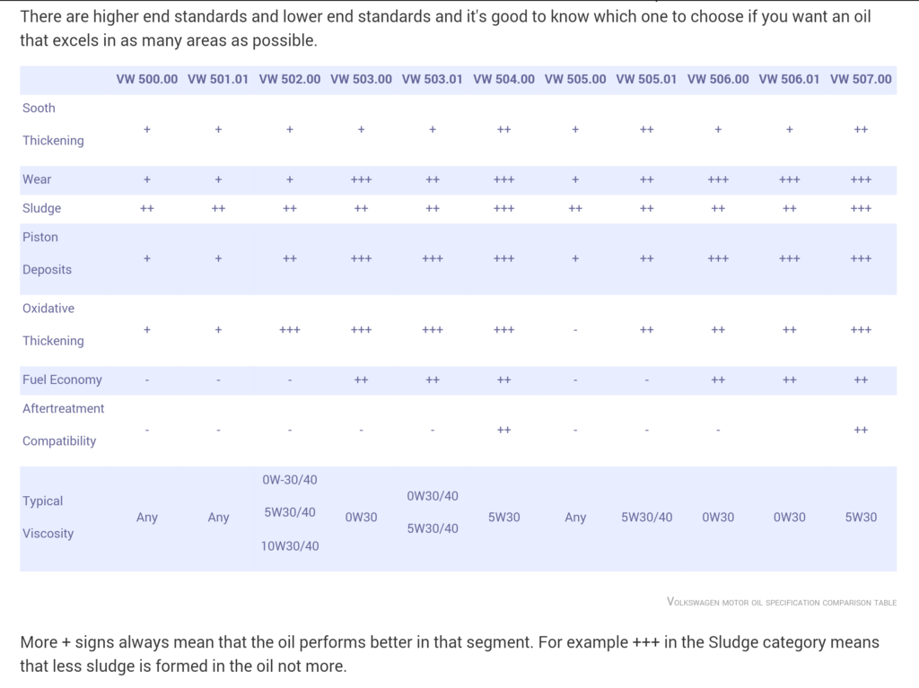

    Well my friend VW via a commissioned German labritory have labled 505.01 a medium quality oil and 507.00 as high quality.
    Without going into too much detail about oil basestock groups and additive packages , here it is .
    The 507.00 superiority is also confirmed twice more by two separate sources .

    Hi
    That's an interesting one, I've been told in the past that the 505.01 oils have very high levels of antiwear additives compared to other 'normal' oils, the level is similar to the top end performance oils. I've just spoken to someone who had an oil analysis done recently and his results showed the ZDDP level in PD oils are similar to performance oils and much higher than 507.00.
    Cheers
    Tim
  10. Re: What oil should I use - 04 Passat 130 1.9 TDi
    #20
    May 2012
    Everywhere
    2,938
    308 Post(s)
    That's true , 505. 01 does have a high anti wear additive package and those same ZDDP anti wear metals that burn as you know with high ash making 505.01 unsuitable for dpf.
    There is a funny confliction with Quantum 505.01 ( VW's own oil )
    So to develop a suitable high anti wear DPF friendly PD oil (507.00) they had a higher concentration overall additive package with higher quality ( higher group oil basestocks ) .
    The result a better oil .
    A LongLife oil has to retain it's qualities for longer , making it more , soot , water and fuel resistant .
