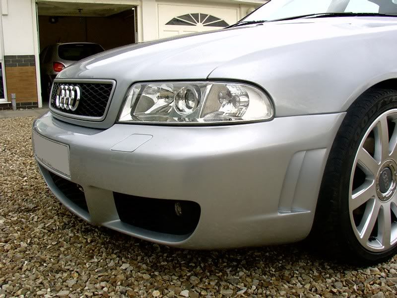

    OEM RS4 bumper install.
    This is the "great" "packaging" which in the bumper was sent to me! The bumper was newer used, but It was full of scratches.
    I started to test fit it, so I know how much it must be changed. The RS4 bumper is about 3 cm wider from the sides than S4.
    Then I made a guide which helps to set the sides to correct position.
    After glueing the guide to the bumper, I put the fiberglass filler to it.
    The front light washer covers wasn't shipped, so I made those by my self.
    The side mounts are different in S4 and RS4, so i removed the old ones and made new mounts.
    Here is the final result, I think that it's better than the original S4 bumber. It fits there quite nicely.
