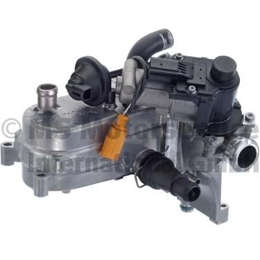

    From those codes, I would start with a new genuine EGR cooler, revised part number 059 131 515 ET and £781.20. From a vague memory I do recall there being a back order problem with these genuine so alternatively I would consider the Pierburg 7.01106.38.0 for approx £450, but nothing else aftermarket.
