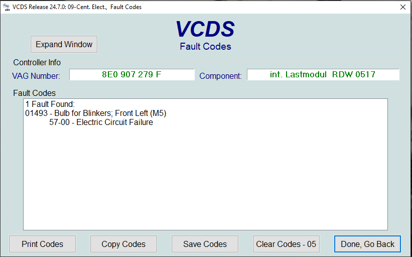

    After checking module (09-Cent. Elect.), I found this error code 57-00 Electric Circuit failure.
    So, is it the headlight connector into the headlight, CCM or am I not going to know without physically wiggling the connectors?
