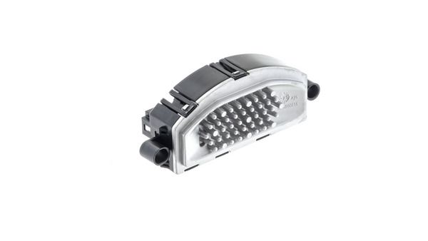

    Both are more than likely Chinese Replacement Auto Parts, the Valeo one I bought last week was and everything I buy from Mahle seems to be chinese. If the power feed is still there and the fan controller has been replaced, then check the condition of the pollen filter and also the air intake in the plen chamber for obstruction such as foliage.
