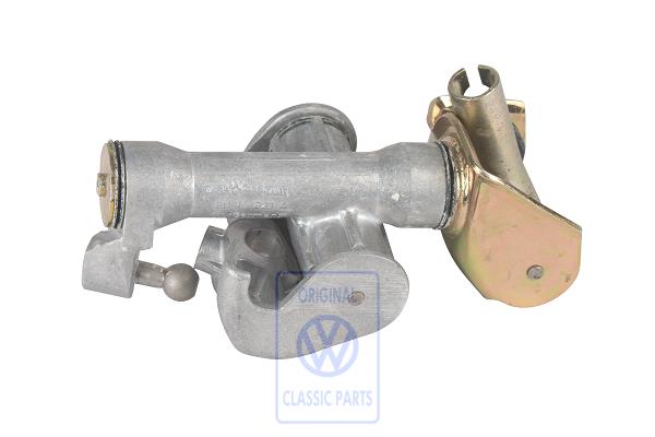

    I wonder if anyone can help with either a part number for this missing oval bush or where we can obtain it? It’s for an 1986 Audi 80 B2 five speed. IMG_1280.jpgIMG_1279.jpg

    You never could buy the bushes, >08.85 you bought the two side bars (31) 811 711 552 A and (32) 811 711 552 A or the full assembly (48) 811 711 613 C which went obsolete in 2005, VW Classic have the full assembly. The depressing point is I was doing these on Passats and Audi 80's in period...

    Thank you for all that information Crasher. Does the (48) 811 711 613 part fit the Audi 80 B2 as it looks quite different? It’s also a bit of an ouch at that price if it does not.

    It is a long way back but I remember doing this, unfortunately ETKA is of little help. The B2 is a type 81 and the part number start 811.

    I have this from ETKA, I shows the cars it fits roughly
