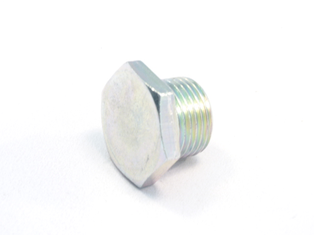

    I'm struggling to pinpoint the correct adapter for emptying and filling. Is it the vag 1924? This is hard work! Can see no mention of the correct tool for the 09B specifically. Help appreciated

    This is the drain plug which is described as 17/18 but I need to be at work to look this up. When doing jobs like this you don’t think about it and just get what you need out your box.
