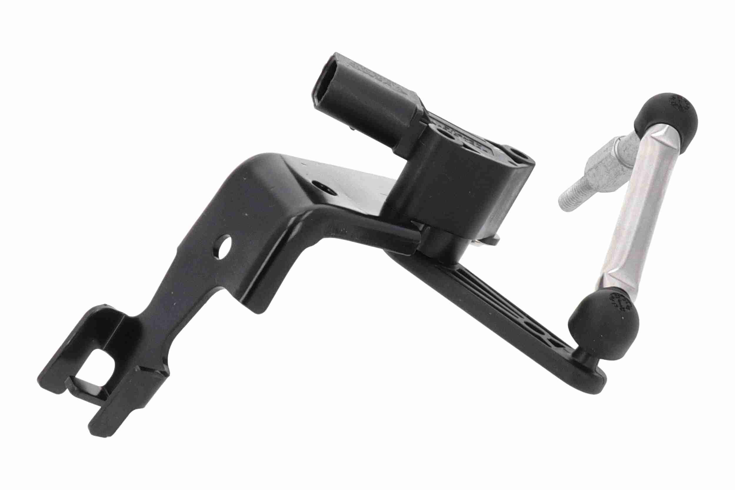

    The left height sensor is faulty, what is the VIN?

    If the wiring looks good, replace the level sensor 4M0 941 285 D which is £192.60, there are some good aftermarket versions such as the Vemo V10-72-0218 and there are some Chinese Replacement Auto Parts.

    Thanks crasher, turns out some rodent had chewed through the cable. Garage fixed it so luckily didn't need to change the cable. Bloody annoying though!
