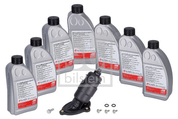

    NDU is 0AW serines, in the case of the NDU 0AW 300 046 R 006. The fluid is G 052 516 A2. A standard drain will only get approx. 50% of the old fluid out, to get approx 90% out, a special purging procedure is required whereby you can get approx 6 litres out of the 8 litre dry capacity. The externally accessible filter is 0AW 301 516 H and we would use the Febi 176878 kit

    Thanks, ordered a kit. Is the procedure to get the extra oil out described anywhere? I have watched a couple of videos where you hook out a little tube to get more oil out, is it more involved than that?
