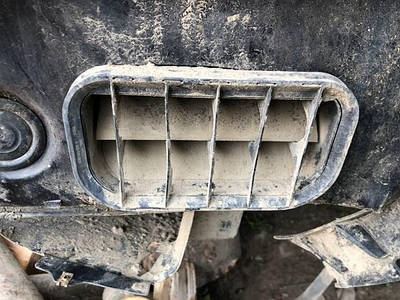

    How about the vents behind the rear bumper? Notorious for letting water in. Revised number 3T0 819 465 A
    Took them out and cleaned them up, put them back in with instant gasket around them 12 months ago. Might have to try them again with all weather sealant instead. I think instant gasket prefers pressure. Or just spend £40 on new ones and no sealant
    Had a little further dig, once again this corner is sodden, so it’s either something higher on this side and it’s trickling down or it’s something around this vent. Bizzar, other option is to leave this bung out lol

    Fit the new vents and seal them in with none setting Butyl rubber mastic, this is how we do Golf 7, you can see the sealant oozing out, VW part number D469101A3, I don't know of an aftermarket alternative, it's amazing stuff.
