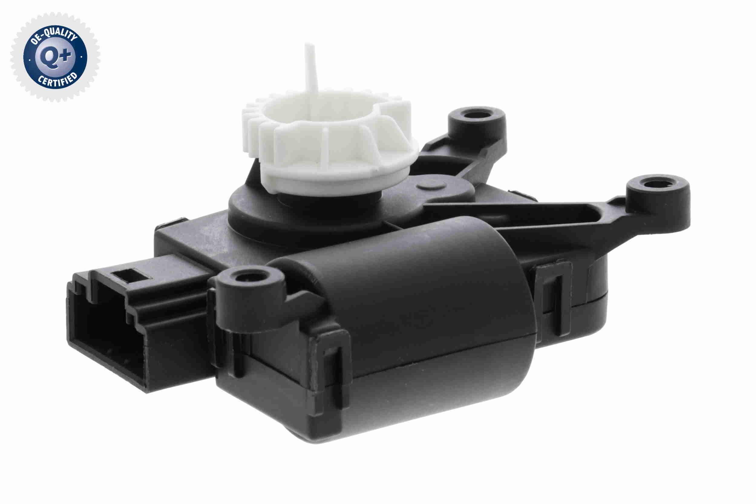

    I've just got back from a similar trip (1200 miles) with the same problem. Turning the compressor off then on again reset the system but it eventually got warmer half hour or so later - it doesn't happen on shorter trips. Local garage has diagnosed a motor that controls the flap up above on the drivers side footwell - will report back with what was done/parts etc, not booked until Oct as getting rear shocks done at the same time....

    For those that are interested - it was the temperature regulating valve that was causing these air con issues - part number 5Q0898511K

    That is the right temperature regulating flap motor
