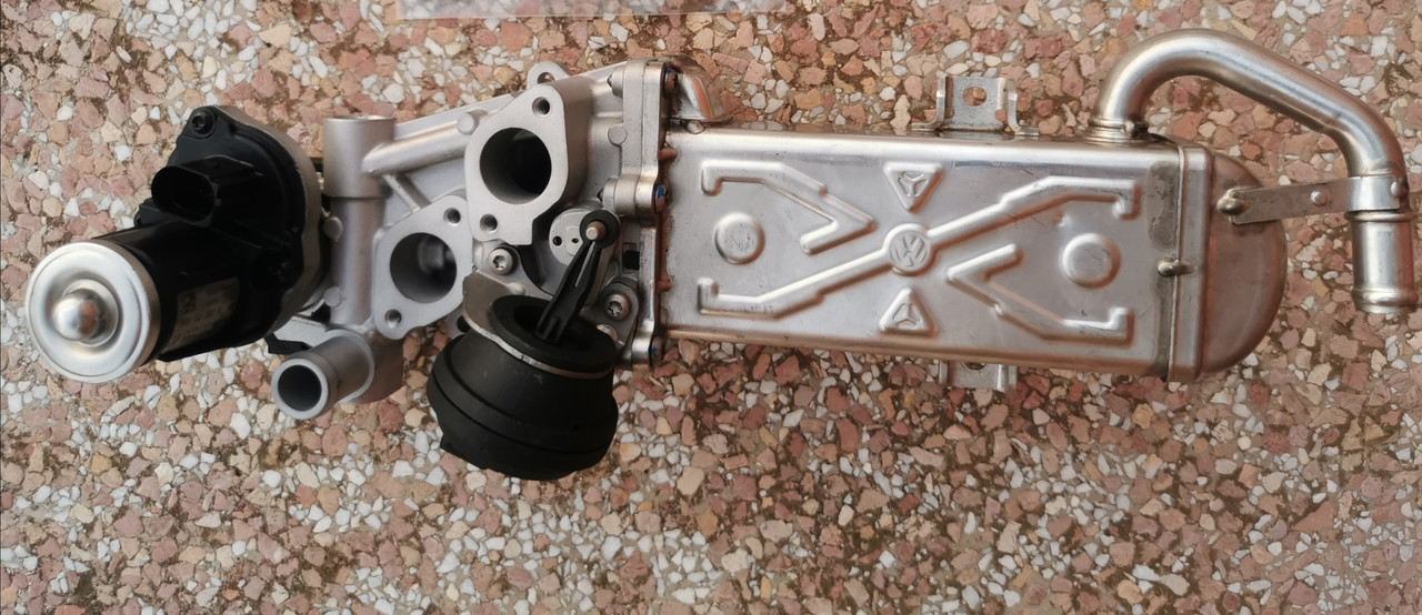

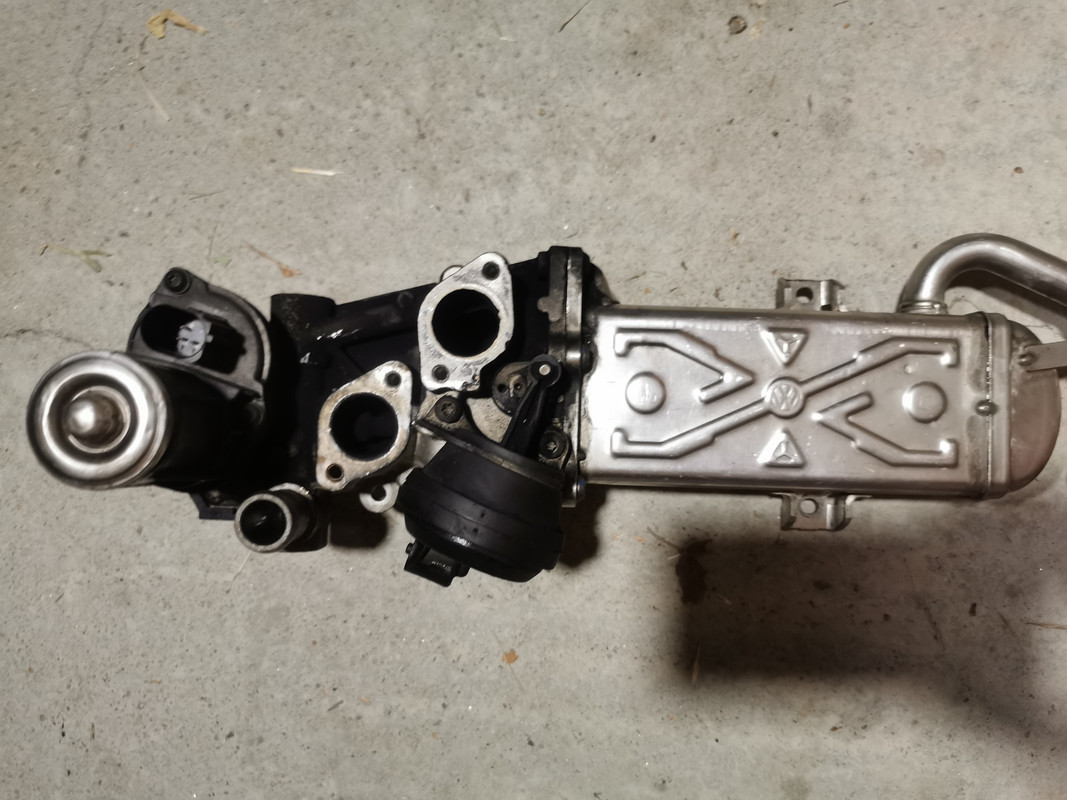

    I have mounted Wahler (it has VW AG sign). It should be the genuine, looks and has the same lettering as the factory valve had. Previous EGR valve was BorgWarner with Wahler cooler.
    Here is how looks the new one installed:
    And this is the previous BorgWarner that looks like was running 200k miles:
    Because of that my question was should I do something else in VCDS beside EGR adaption in Basic settings which I've already done to check if everything is fine with EGR and running smoothly? I hope that the old valve was faulty from the beginning and there isn't anything else faulty that could lead to premature EGR failure.

    There are EGR tests but f it is happy don't bother.
