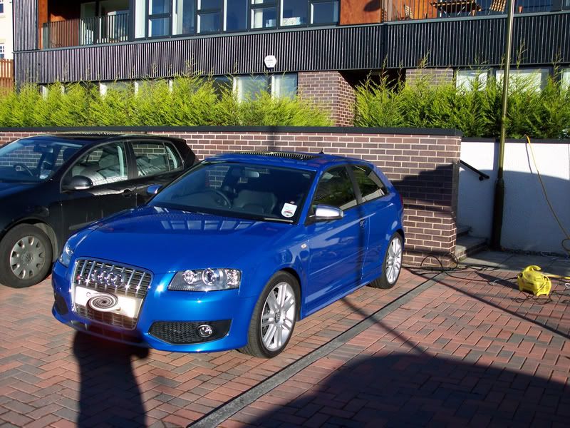

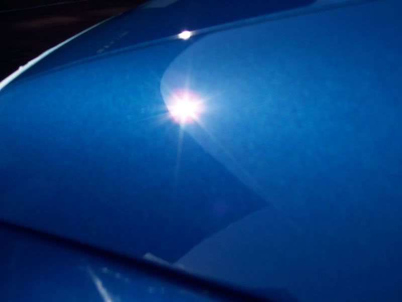

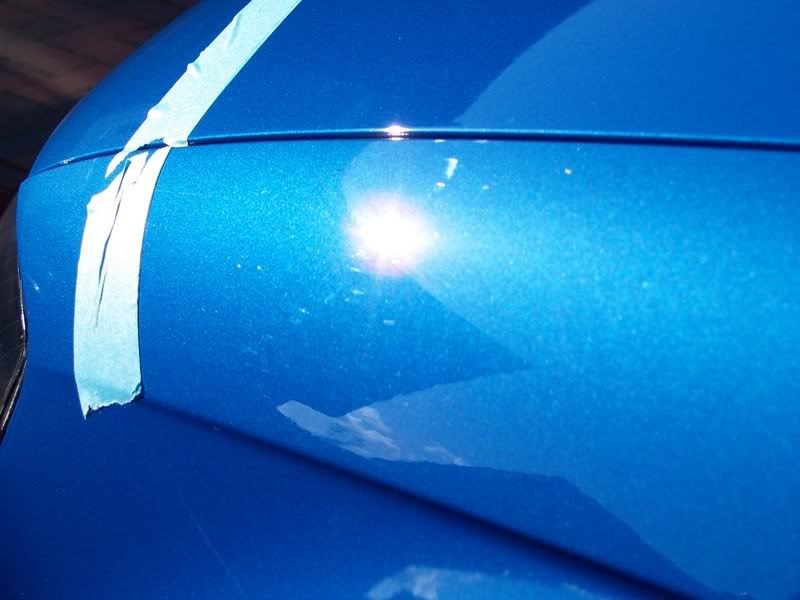

    I was asked to remove the £300 Supaguard sealant (about £30 for the dealer to buy!) from this 1-wk old sprint blue S3. The panels were to be machine polished with very fine Menzerna Final Finish polishes to remove the SG, tease out the gloss and to remove some very fine marring that was on every panel.
    The car was nice and shiny but lacked a bit of depth and liquidity.

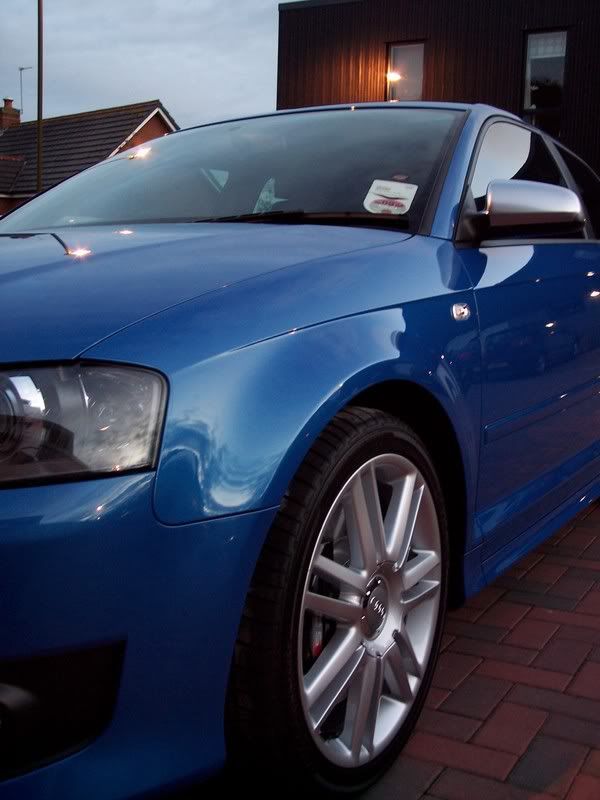

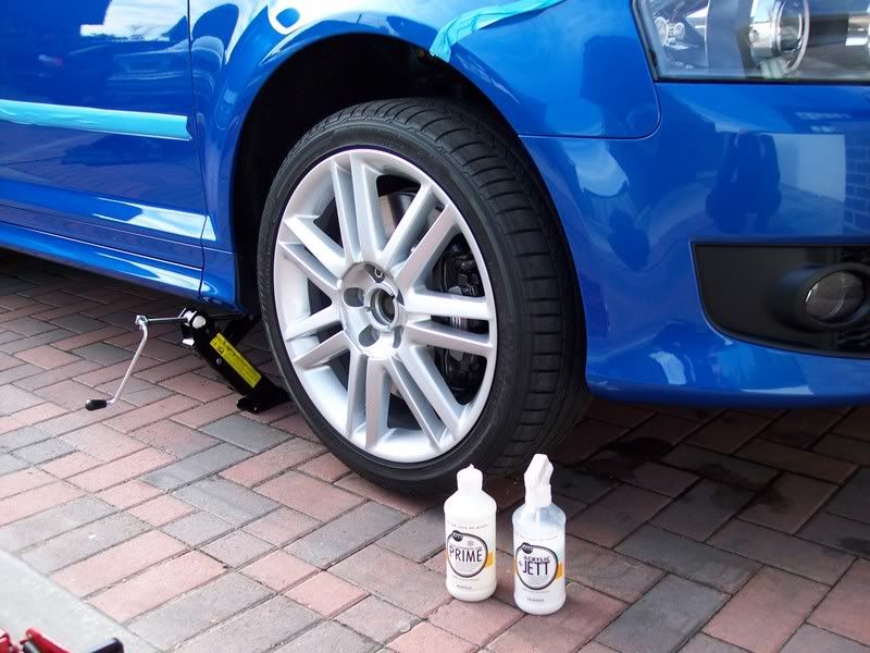

    My mate was very fussy about the wheels and decided he wanted them off so I left that up to him. They were cleansed and sealed with JEFF'S Acrylic Prime all-in-one and given 3 further coats of acrylic sealant by means of JEFF'S Acrylic Trigger.
    Tyres were dressed with 303 Aerospace Protectant.
    Pre-wax cleansing was Zymol HD Cleanse and final protection was the lush Zymol Glasur 57% Carnauba wax.
    Car foamed, rinsed, clayed, rinsed, dried and taped up ready for the Makita.
    Before
    Minor marring

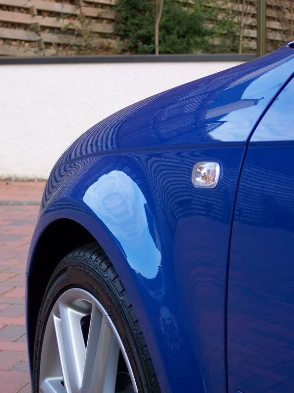

    Corrected
    Wheels Off

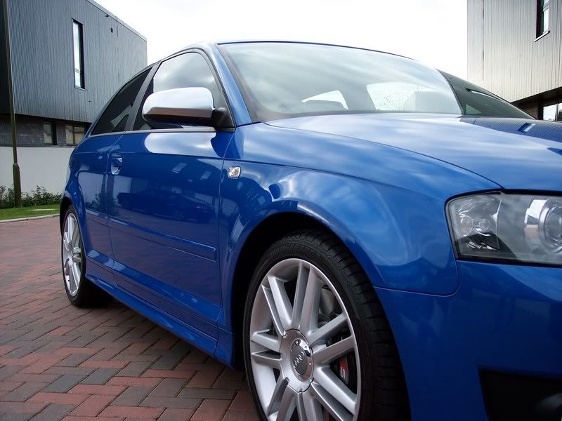

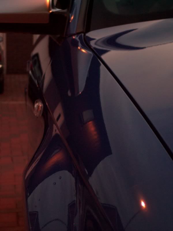

    Afters
    A cracking car to work on.

    FATBLOKESCANFLY: It was over 2 days. The car was given a 2-stage rotary polish; first stage was a cut of 4/10, gloss 9/10 polish and second stage was a cut of 1/10, gloss 10/10 polish. The first stage removes minor swirls and scuffs and contamination that can't be seen by the eye. It was also required to remove the unwanted 'Supaguard' product that the dealers insist on applying.
    After the polishing stage, the surface was deep cleansed with a good cleanser which glazed the surface in readiness for the 57% high-grade carnauba wax protection. This final stage took 3 hours alone. The level of finish is 95% due to the level of surface prep. The cleansing and wax just give the paint that extra bit of warmth, depth and glow.
