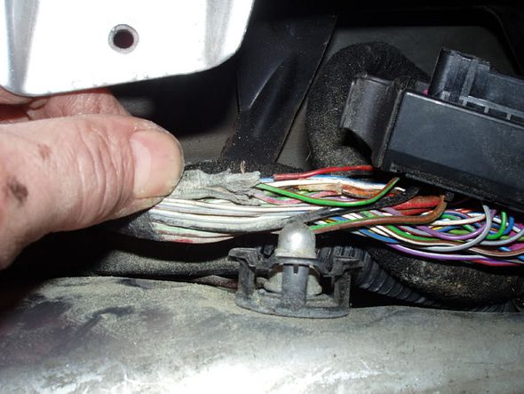

    18010 (P1602) - Power Supply Terminal 30 - Voltage too Low - Intermittent
    Open up the wiring to the ECU and follow the thin 0.35mm CSA red/green back to a connection of a 4mm red/black and a 1.5mm red/green which is the terminal 30 power feed. These corrode on cars up until 11/2001 build.

    Hi Crasher, got my mate to check that wire at the ecu all good solid connection no break and not coming out of the splice. Any other suggestions or places to look?
