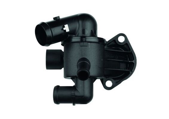

    Golf 6 matix blockage isn't common but the thermostat failing in the open position can be. I would do a back flush and new thermostat using G12 Evo ready mixed coolant.

    Many thanks. I'll get onto my garage and see if they fancy taking the job on - it doesn't look like the thermostat is an easy job. Are aftermarket stats ok or is it best to go O.E?

    I go genuine unless I can get somthing top end like Behr, the usual version is part number 03L 121 111 AM
