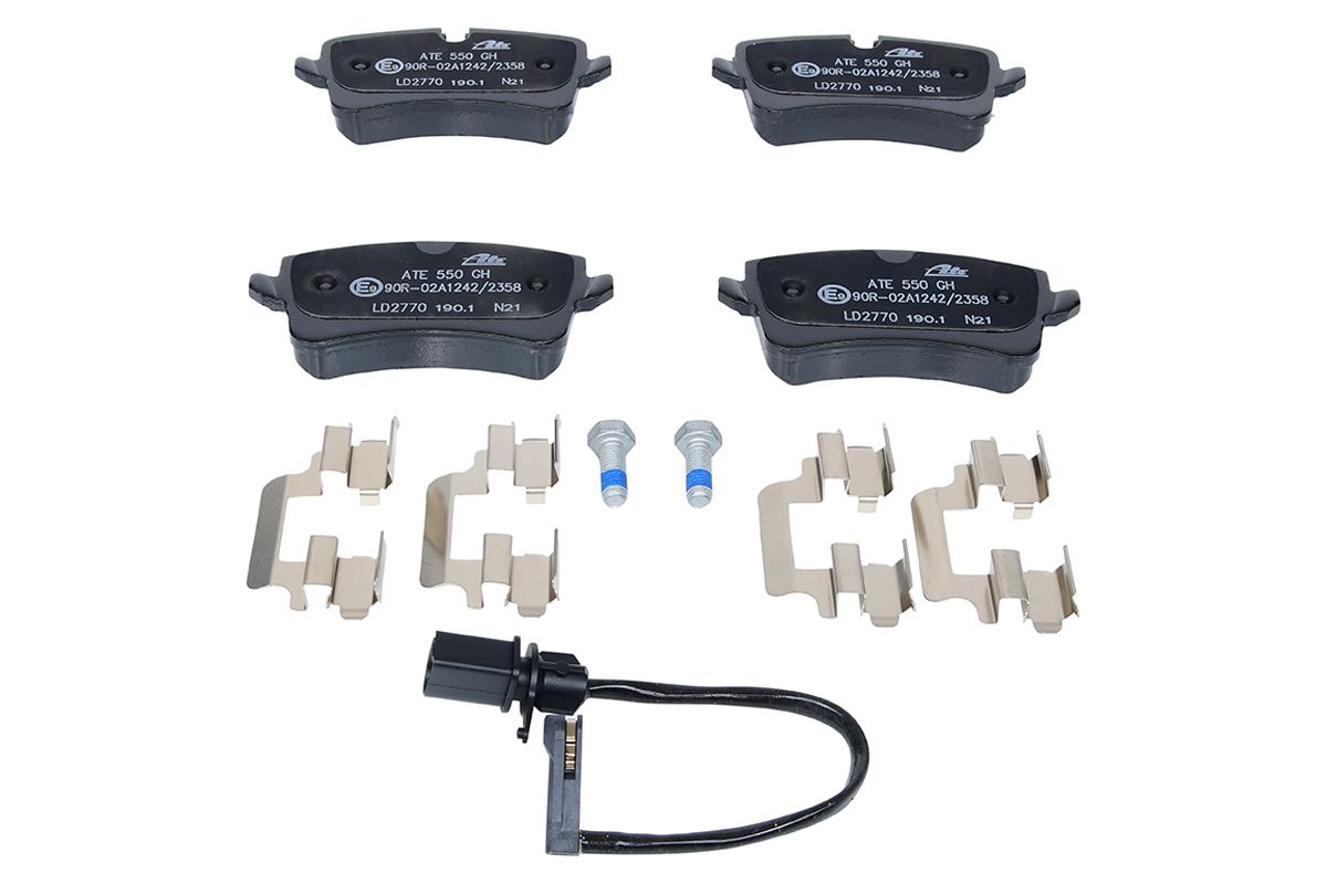

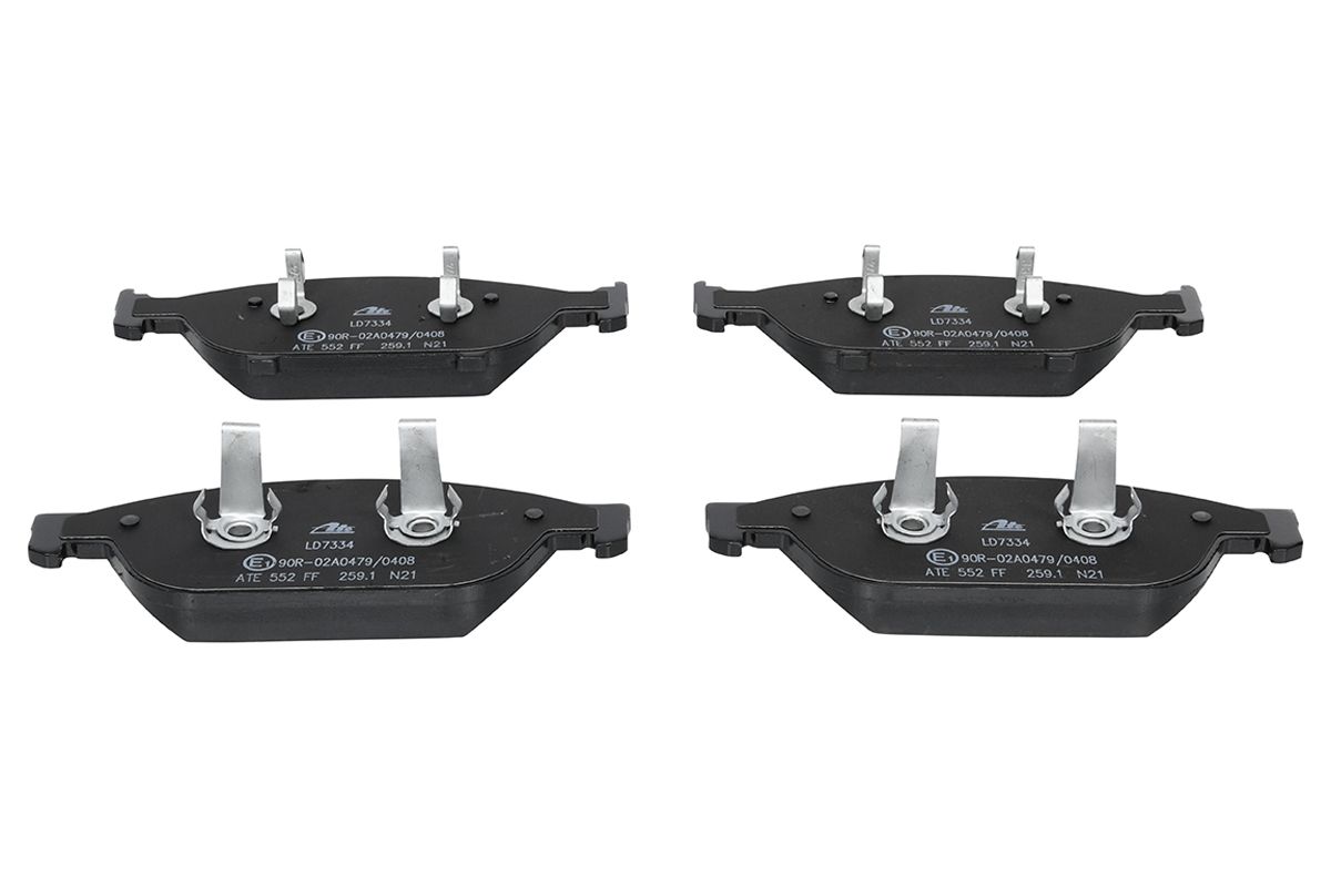

    Fronts
    4G0698151M
    1LL
    Rears
    4G0698451L
    2EA
    All this is quite confusing, but something that I would like to understand so based on the information provided and the fact that I'm curious to see what ceramic pads would be like, I've ordered:
    Fingers crossed they are the right ones. If not, at least I'll learn something

    4G0 698 151 M are ATE ceramic 13.0470-7334.2

    4G0 698 451 L are ATE Ceramic 13.0470-2770.2 with shims for vented discs
