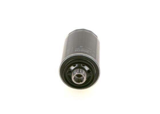

    The OE number is 06J 115 403 Q which is £17.24 and looks like this, which make did you fit? We only fit genuine VW.

    Many thanks for taking the trouble to check on this. I'm not sure of the make of the aftermarket filter, but it looked exactly like the one you showed.
    However this is the one I removed. the body is the same diameter and length.
    I am beginning to think the shop was right and some how the spigot stayed on the engine instead of being removed with the filter.

    What is the Bosch number on that filter and the cars VIN?

    That still gives me the current (there are earlier such as B and J) number of 06J 115 403 Q which would be a Bosch F 026 407 080
