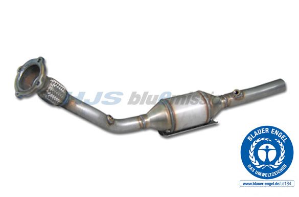

    Yes, it will be, it leaks into the downpipe. When I bought my Octavia 1U VRS (AUQ engine) about 17 years ago it had a damaged engine due to sump sludge. I fitted a new genuine unit and went for a drive, came back and ordered a genuine turbo. A genuine cat is still listed under 1J0 254 506 SX but is £1945.20 exchnage so you would also get hit with a couple of hundred pounds surcharge. When mine failed I went to a Jetex downpipe and APR stage 2 remap but later replaced the cat with an EU5 spec unit. Aftermarket the only one I can recommend is the HJS 96 11 4073 but the problem is buying one. You know who stock them for £812.

    77
    So ignoring the missing cat, why do you think it's the turbo? What checks can I do to confirm it is the turbo? I'm going to do a leak down pressure test this weekend and also clean out the PCV system to see if that helps but with 137k on the clock, my feeling it was the valve seals.
