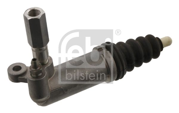

    have a problem, i need the connection between the cylinder the pipe? vw said its the full pipe but its discontinued, part am after is broken in the attached image

    hi mate, would the reg help? am not able to get to the car tonight. this is what am after, but these are in poland. i think the pipe/adaptor are an older design. ive been trying everywhere, even a full pipe from a later model/used would do. found some new be they wont post untill after the year

    It is too old for the VIN to work in FI Suggestion, I get the part number as being 8E2 721 465 which means it is the same as a type 8E A4 and yes, it is obsolete from VAG UK. VW Classic have them, but guess what, so do I! I looked at the picture on VW Classic and thought "I am sure I have one of those in my NOS stock"

    the pipe i have is ok mate, its the same as yours, you see the flanged end like a brake pipe, i either need the adaptor for that, that connects to the slave or the later pipe that has the fitment on the pipe instead of the brake pipe style end. hope that makes sense, thanks

    I can see the problem now, you need the earlier slave cylinder 8E0 721 257 B which Sachs no longer sell but others do such as the Febi 26868 which is in stock

    thanks mate. looking at the end of the alloy adaptor that looks like a circlip type? is that threaded? need something for the bolt and flanged pipe to fix into

    Yes, I think you need to earlier type for cars upto 99 ish chassis, part number 8D0 721 257, Febi 34919 and three times the price, in stock still

    You could be onto something mate, it looks like the mount hole is positioned alittle different?
