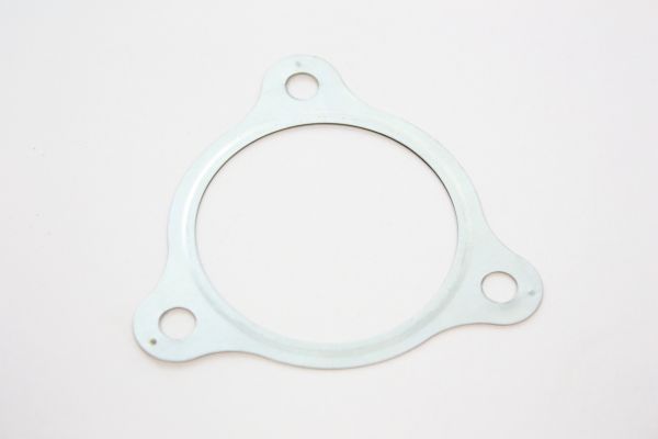

    180118bchris029.jpgcould be 8D0253115C

    Quote Originally Posted by arman123 View Post
    I bought this one. The bolt holes are perfect but the centre bore is too large. I require a centre bore of about 60mm. The first one I got is 56mm and the second one is 74mm. The old gasket has flaked apart but what's left of it can be measured as 60mm centre.
