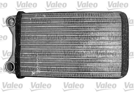

    Try the flush. I first used the hose several times in both directions. I got some system cleaner and put it in the core and let it soak for an hour. Follow by hot water then the hose flush. It worked for me. If the core is blocked you will need a new one.

    Thank you. First job after Christmas. Just in case, I checked your parts list and the core seems to be 4B2819011 I'd be grateful for your confirmation? There's a 4B1 as well so I guess it will be 'handed?'..... Merry Christmas to all.

    That is the part number for the Aux heater.
    You need item16 8E2820031. that is the heater core for RHD, Use the OEM as aftermarket ones are not so good.

    Yes 8E2 820 031 and £280.78 plus you need the seal kit 8E0 898 380at £22.91
    There isn’t a huge choice aftermarket, about the best would be Valeo which is OE
