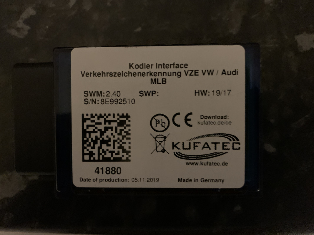

    Yep, the Kufatec dongle definitely works 100% on the C8 (did it this morning on my 2020 A6).
    This is how I did it:
    1) Open bonnet
    2) Switch on ignition (not engine) & wait for 30 sec.
    3) Plug dongle into OBD port
    4) Leave dongle plugged in until red LED on dongle stops flashing - takes about 1 minute.

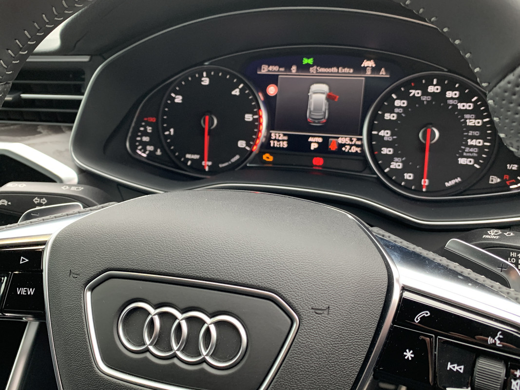

    (NOTE: during coding the dashboard will display all sorts of warnings/error messages/gobbledy gook, DO NOT PANIC as its normal)
    5) Remove dongle, switch off ignition and close bonnet
    6) Lock car and wait at least 10 mins before starting car.

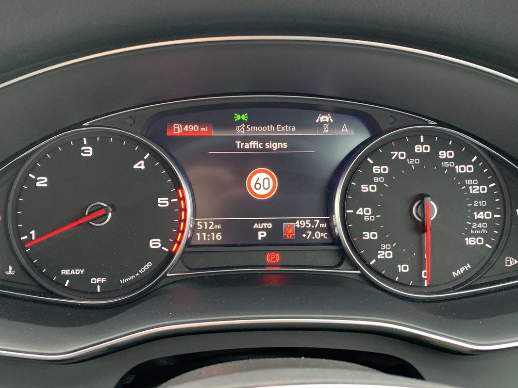

    7) Once you start driving, the car will permanently display a speed limit sign as soon as it picks up the first one.
    This is the one you need to buy:
    https://www.kufatec.com/en/coding-di...for-audi-41880
