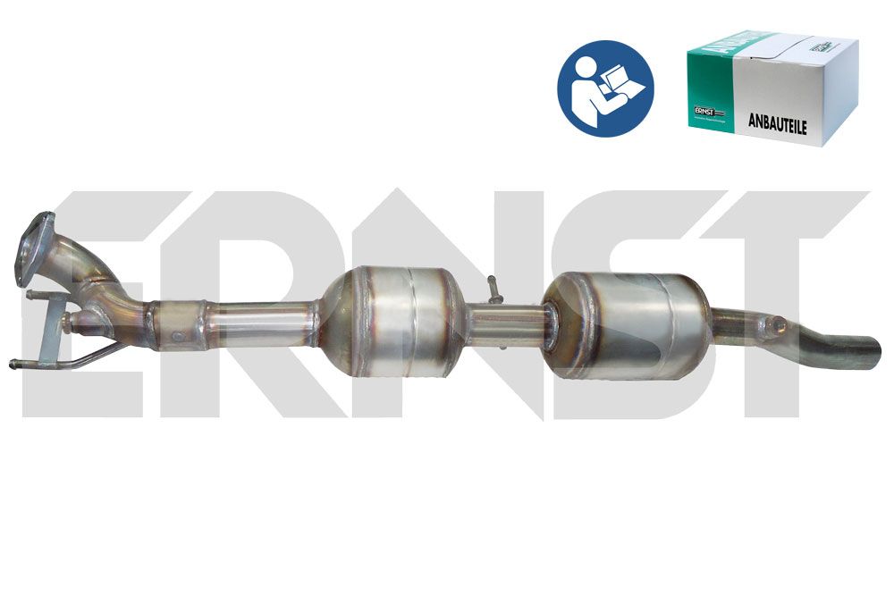

  10. Re: Oil level rising VW Sharan 2015 2.0 TDI 103KW
    43,256
    131 Post(s)
    1976 Post(s)
    The only one I would consider is the Ernst 761000 but it is getting one that is the problem.
