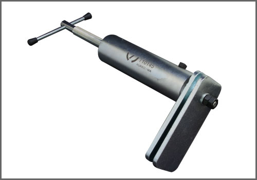

    The pistons must be pressed back only using a propriety piston resetting tool such as the VAG T10145

    Sometimes you may find that after using VCDS to wind the piston back there is still not enough room to fit the new pads and put the caliper back in place, even more so if you have also replaced the discs. So you sometimes need to use a tool as shown in Crasher post to push the piston all the way back.
    You don't need to use a wind back tool (that is for the non electric rear calipers).

    Yes, I should have made it clearer but I couldn't find the VAG text I have read where it specifically states that the pistons MUST NOT be would back as it can damage the mechanism, they just need pushing back, even a big pair of grips will do.
