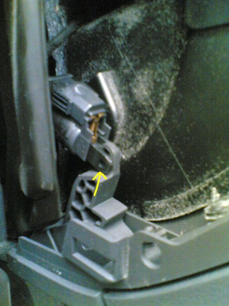

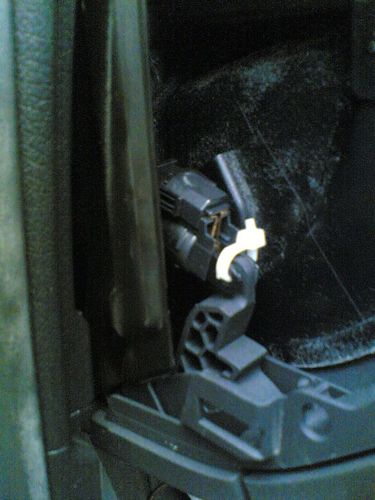

    thought id take some pictures of what was causing this glovebox to fly open undampened, its a really easy fix woo! just did it in about a minute.
    obviously the loud crack was from whatever was going through that hole holding the glovebox and the dampening mechanism together.
    so i stuck a cable tie through it and it holds just fine, better than buying some bit from vdub thats going to cost you and arm and a leg
    not that u need to see what a cable tie looks like but i thought id put this picture in anyhow
