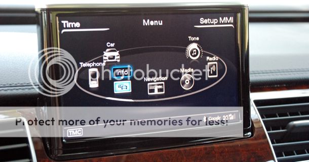

    Sorry, probably wasn't clear. Basically my car screen look like this...

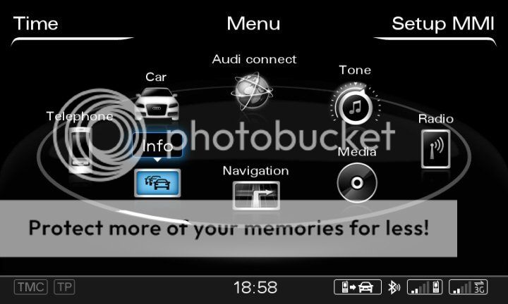

    I am thinking and hoping a software update may make it look like this....
